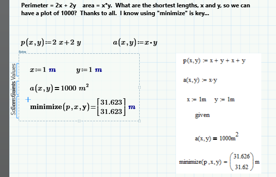

I'm sorry but this is so basic... but how do you set up a sheet and solver block for this?  Perimeter = 2x + 2y    area = x*y.  What are the shortest lengths, x and y, so we can have a plot of 1000?  Thanks to all.  I know using "minimize" is key...

The solution is sqrt(1000).= 31.623
And with the minimize function:
And in case you're using Prime instead of proper Mathcad, here's the Prime 3.1 solution (with Valery's solution alongside):
It's interesting that Prime shows 31.623 but M15 doesn't (I checked in my M15 M040)....
Stuart
September 6, 2015
Looks like a bug in MC15. Same here with MC15 M030. And it has nothing to do with the units.
Solution is too far away from the square root and when CTOL is set smaller, an error is thrown (and it cannot be traced back to "no solution found"). Strange!
Have not tried but from what I saw above I guess Prime will get the correct 10,10 solution.
