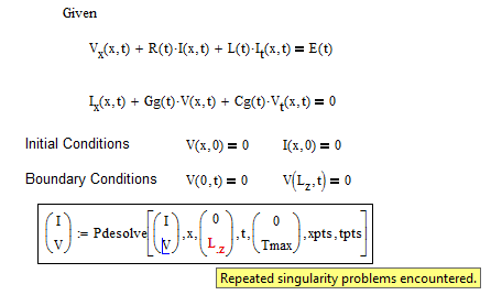

I am new to using the Odesolve and Pdesolve functions; see attached Mathcad 15 file.

  6. Now, when I try to solve the complete buried transmission line equations with the Pdesolver, I get the error that V is undefined as shown in the attached.  Why?

Hi Reg Curry,
The partial derivatives of the unknown functions are not written correctly.
with their related initial and boundary conditions ....
You also have to use literal indices (V.x) and not vector indices (V[x) as you did. Probably that was the reason you ended up with the multiplications FM pointed you to.
Furthermore you have too many initial conditions - you will have to delete E(0)=0 as you don't solve for E anyway.
After correcting all of the above it works, but after a while we get the error "Repeated singularity problems encountered". Maybe you'll have to recheck your equations and conditions.

Thanks much guys.  Both F.M. and Werner are correct.  Not only do I have only 3 neurons left working, my eyesight is failing at 74.  I accidentally first used vector indices and then just deleted them and inserted literal indices. Apparently that caused the multiplication problem.  I never noticed it.
F.M--the equations I am trying to solve have a uniform electric field over the entire line, that is the reason for the syntax of the equations.
Werner--after making the corrections you and F.M. noted, I get the same singularity problem you note.  At present, I am not sure where the singularity problems arise.  I have solved the same equations using explicit differencing in Mathcad with no problem.  I need to do some more thinking on this.

Thanks for the clarity about the uniform electric field along the line, I thought it was excited at one extreme. Even for me, the program does not work. Let's see if Werner succeeds.
I would still wait to see if there are others, in the community, who want to contribute, with their help and experience, in dealing with the problem.
