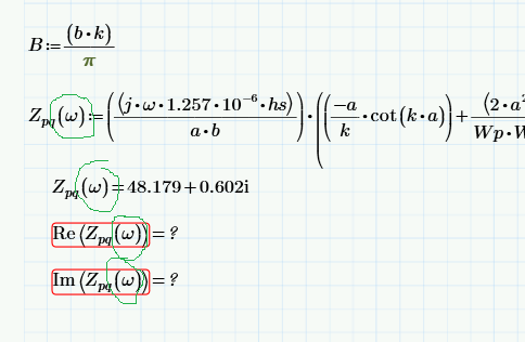

So I'll show you in pictures what I've done, so you can rebuild it in Prime 3.0.
Her goes:
Add (omega) to definition and all evaluations of Zpq.
Note that I get errors for the Re() and Im() functions because Prime Express considers them 'advanced' functions, too good to freely give away.

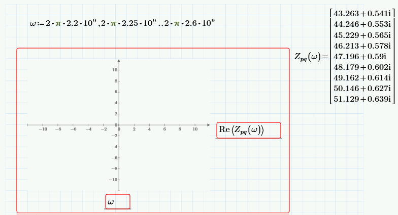

And here's the definition of omega as a range.
The definition of a range is: <first value>,<second value>..<end value>
You enter it as e.g. 2.2,2.25;2.6 to get 2.2, 2.25..2.6, then add the other multiplications to it.
Again I get an error message, due to the use of the Re() function.

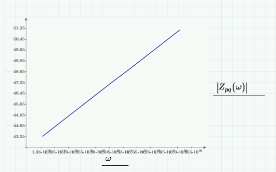

This is my plot of the absolute values (vector length) of the complex numbers:
