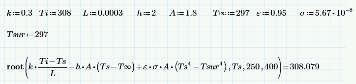

Please see attached Mathcad Prime 3.1 worksheet and advise if I am setting up the definitions and equation up properly.  The correct answer should be around 307, but I'm pretty sure I need to set up the equation a different way.
Should I be setting the equation equal to Ts?
Thank you

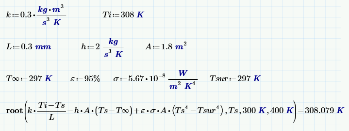

1. It will be good to use units of temperature, length etc in your calculation!
2. Better use root not Given/Fimd

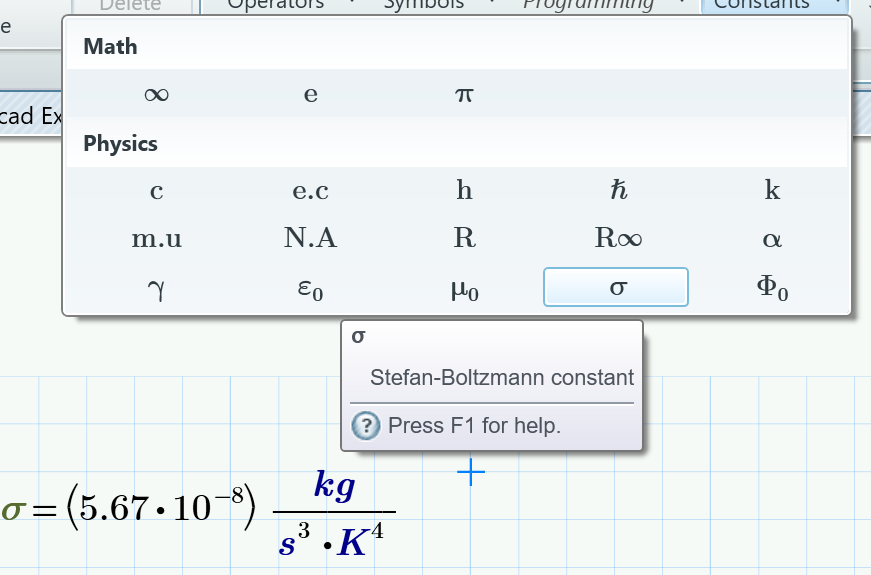

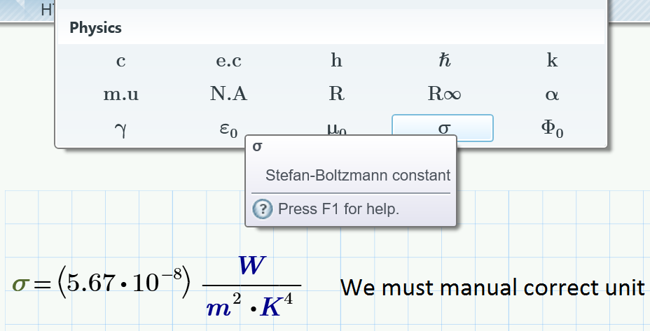

Are you sure the units for thermal conductivity are correct?
This is what I have:
January 19, 2017
January 19, 2017

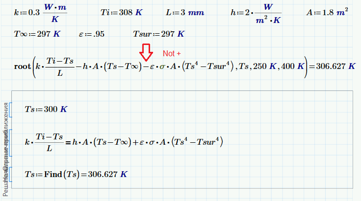

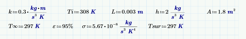

Attached is my updated worksheet where I have used both the root and given/find applications.  I noticed that the variable, L=0.003 m, not 0.0003 m, therefore the answer of Ts changes (extra zero, sorry!).
The given/find solver gives Ts= 306.627 Kelvin.
The root solver gives Ts= 308.852 Kelvin.
The application of this problem is to find the surface temperature of the human skin (Ts), due to the internal temperature (Ti=308 Kelvin).  Therefore, the heat loss due to conduction of the skin, convection to the outside air (air temperature is 297 Kelvin), and emissivity of thermal radiation, Ti has to be greater than Ts.  I have go to with the answer of Ts= 306.627 Kelvin.
Thank you for all the help.
Sorry - it was my error
