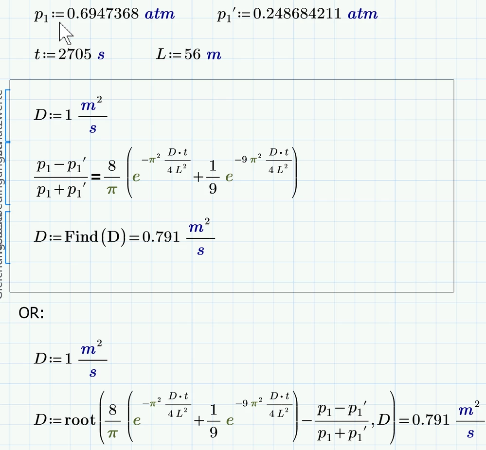

I am new to Mathcad and having issues getting the program to solve for a variable. I was able to get my first equation to work, but when I tried plugging that value into the second equation I started having issues. The program would not let me plug in my value and solve for D. What am I doing wrong?

Not sure if I guessed correctly what you are looking for.
Would the use of a solve block or the root  command as shown in the picture help?
(You can't expect a solution if f1 is negative as with the first set of values you provided)

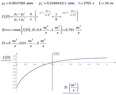

The graphic solution/verification will bee good too
