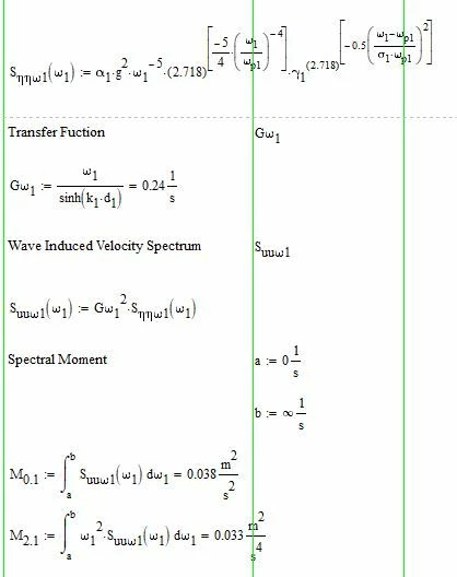

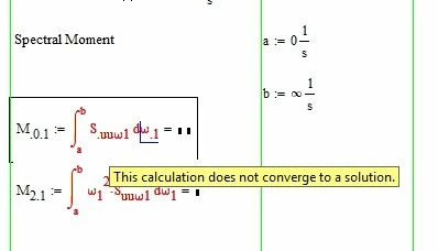

I want to solve the spectral moment from DNVGL RP F105 standard (see fig.2) but in my Mathcad worksheet (see fig.1)the calculation does not converge to a solution. Could somebody please review my work? The file is attached below.
Thank you for your help!
Basyarul
fig1. my mathcad worksheet
