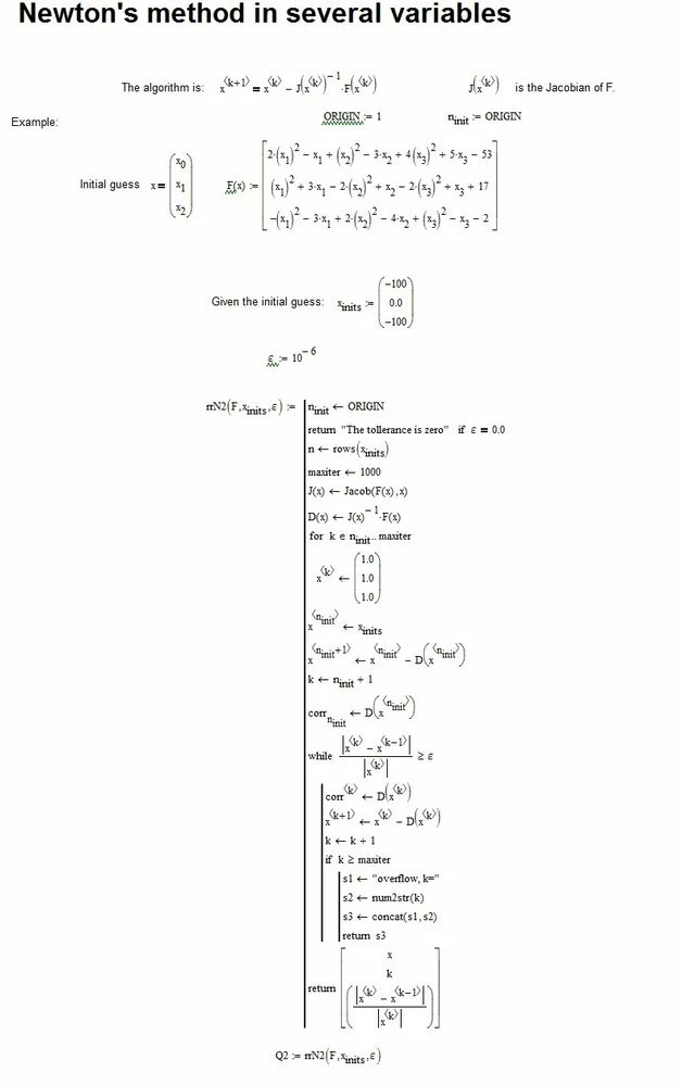

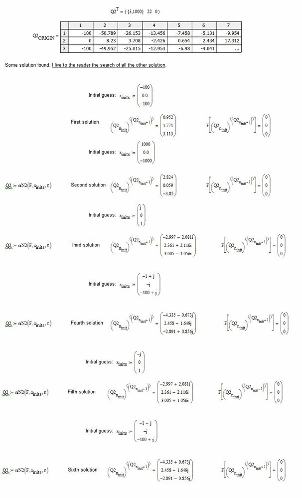

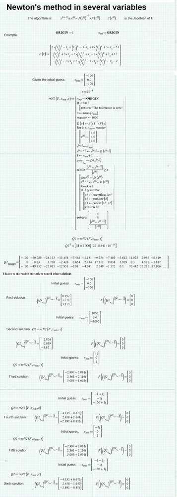

February 21, 2018
1) Newton in several variables.jpg2) Newton in several variables.jpgNewton in several variables Prime 3.1.jpg
February 21, 2018
Nice. Can you post your Prime worksheet?

February 21, 2018
Hi!
I made some changes to your file to fit it to the  program . Each solution depends on the initial guesses that are very difficult to determine.
