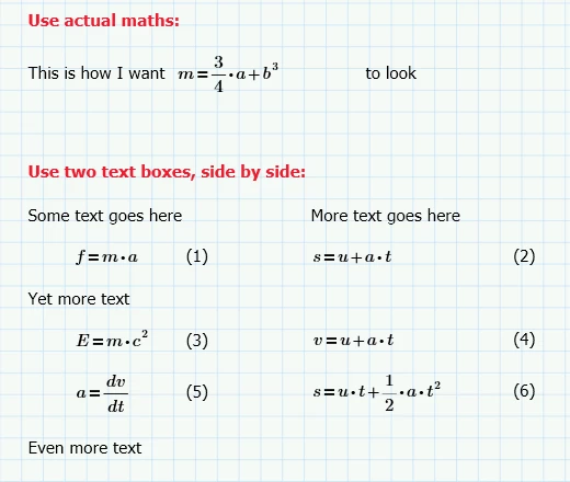

Jul 18, 2025 10:29 AM UTC
This might not be totally satisfactory, but:

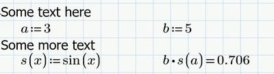

BTW, its easy to accomplish what you show as an example
After the math expression a:=3  I had to hit <TAB> a few times to get that far to the right (as I already said, tab stops are not customisable).
The line starting with "Some more text" was automatically indented and so I had to use the Backspace key to get to the left.
Once the text block is already created, <TAB> seems to act differently and jumps from math region to math region and you would have to use <SHIFT>+<TAB> to insert a new tab space.

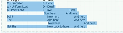

Here's a text block example
Both the first and last indented lines are tabbed over 8 times, they should line up with the "L - Live" above it, yet they don't even line up with each other

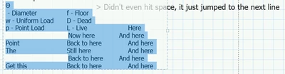

And a text box example
Exact same font, size, and number of tabs used as above, this time the first and last indented lines at least line up with each other
Also, on the first line I typed Θ (Alt+233), which worked fine in the text block above, but jumped down to the next line in the text box below.
