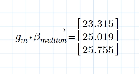

Here is another approach using vectorization.
Oct 6, 2014 11:33 AM UTC
Like so?

Oct 6, 2014 11:37 AM UTC
got it vectorization ! Thanks
