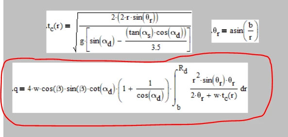

Hi all,
looking for some help to solve the following equation (circled in red) to find one of the limits of integration (b).
R.d is the other limit of integration which is fixed and known.
The angles 'alpha' and 'beta' are known and fixed.
w is known and fixed, q is known and fixed.
Angle 'theta' varies with r and b.
Any help would be appreciatred - currently trying to do it in mathcad 15 but i also have access to prime

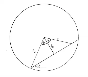

i have attached the calc I have so far. I have also included the paper it comes from, i'm essentially trying to use the derived equation that is the crux of the paper (equation 3.40 on page 77) but struggling to do this in Mathcad. Also included a diagram from the paper to help illustrate where some of the variables come from.

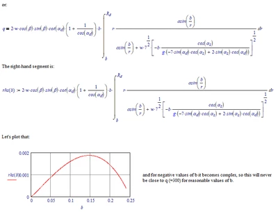

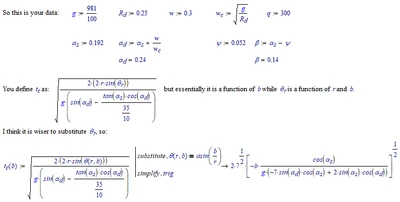

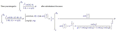

January 2, 2020
LucMeekes_0-1577968186414.pngLucMeekes_1-1577968213702.pngLucMeekes_2-1577968250454.pngLucMeekes_3-1577968275326.png
I think you should check the equations and the known values.
