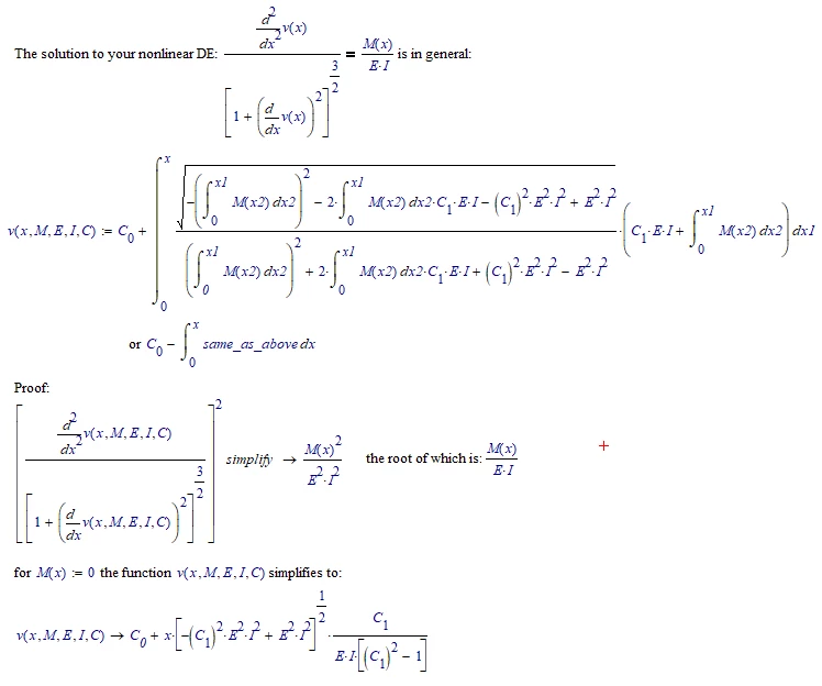

Greetings dear colleagues of the forum, I am looking for help to solve the non-linear differential equation of second order corresponding to a beam:
ecuacion_general.pngIn this equation:
- M is a function that is written in terms of x. This function is variable, it depends on the loads applied to the beam.
- E and I are constant values. The first is the modulus of elasticity (E) and the second corresponds to the moment of inertia (I).
- v is the unknown that I want to obtain and is written in terms of x. Varies for each beam, same as M, depending on the configuration of applied loads.
I am interested in clearing the deflection "v" that occurs in the beam since I am verifying the results obtained with a structural analysis software called Ftool (https://www.ftool.com.br/Ftool/).
In most books they only present exercises using the previous equation but in its reduced (simplified) version:ecuacion_simplificada.png
In this case the solution consists of integrating twice, obtaining:solucion_simplificada.png
Resolving several cases by hand and comparing with that obtained with the Ftool software there are differences in the results, product of using the simplified equation.
I would appreciate any help to solve this equation.

I wanted the numbers to be representative of real life.  I have changed the inertia of the beam to 300 x 10^6 not 3 x 10^6.  This represents a heavily loaded steel beam which deflects a little to much around 19 mm.
The difference in the more refined equation for M is only a fraction of percent and that is why the more complex equation is not bothered with in practical engineering.  It is of academic interest only.

With a little help of Mathcad 11/Maple:
Given a suitable definition of M(x) and boundary conditions to solve the two integration constants C0 and C1, you should be to calculate v(x).

Although solving symbolically can be very long and complex for this equation. Mathcad Prime does not give me a solution for this case, I will try to see in Maple.
January 23, 2019
I gave you the full symbolic expression of v(x,...). You could type that into Prime and see for yourself what comes out in benchmarking. I wasn't able so far, because you did not provide the full Prime sheet and left it to guessing what exactly your system is: I wonder what the definitions of L and M(x) are that you used in comparing the Odesolve results with the results of that other tool.
