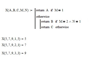

Since you have posted in the Mathcad forums before I assume this is a Mathcad question, in which case the best solution is a small program:
Note that you cannot just type "return", "if" and "otherwise". They must be entered from the programming toolbar.

Thanks everyone for your help. I didn't realize that I would initiate such a discussion.
Actually all I needed was to be steered to the Boolean "and", and then I was all set.
