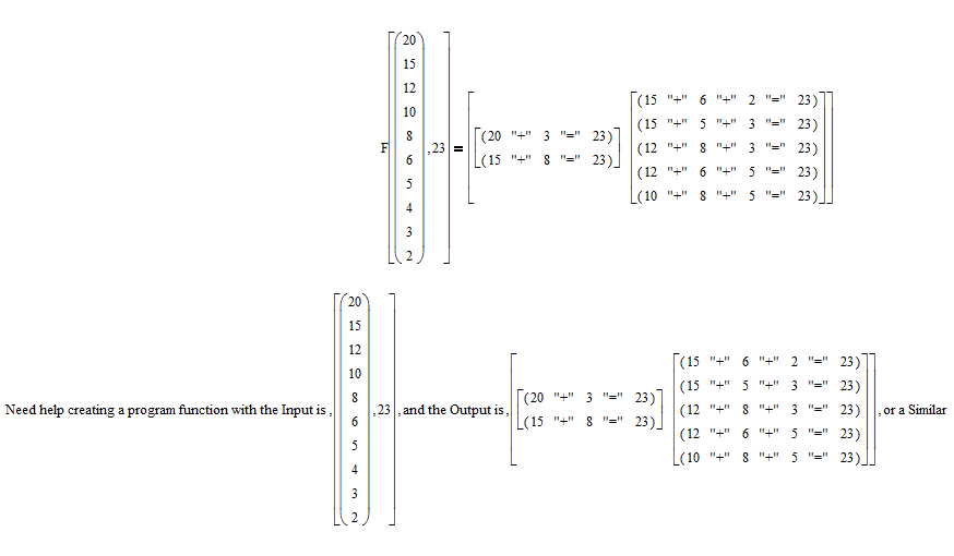

Help with a program function.
  Hello, Everyone.
  Need help creating a program function as the above.
      Thanks in advance for your time and help.
            Regards.

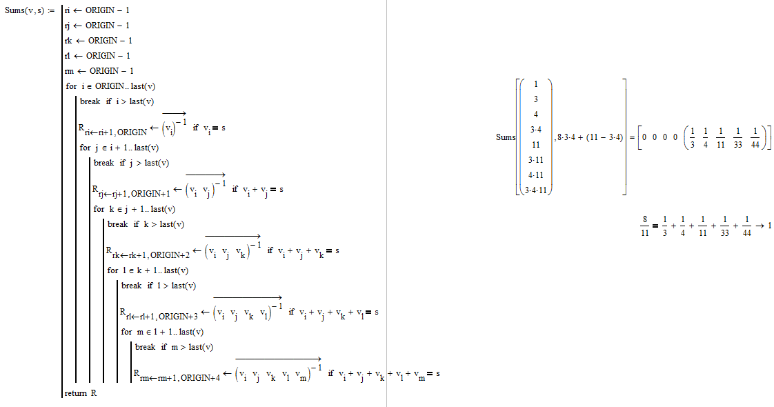

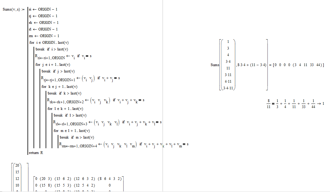

Or similar...
I'm leaving out the operators (all "+") and the results (also all the same), and just give the bare numbers:
What you can see from the structure is that this algorithm is screaming for a recursive approach. But I'm not not clear enough now to think about that....
Other output, shows you what the very first column is for:

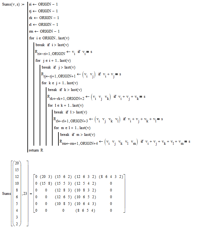

Or similar...
