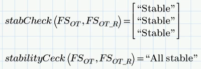

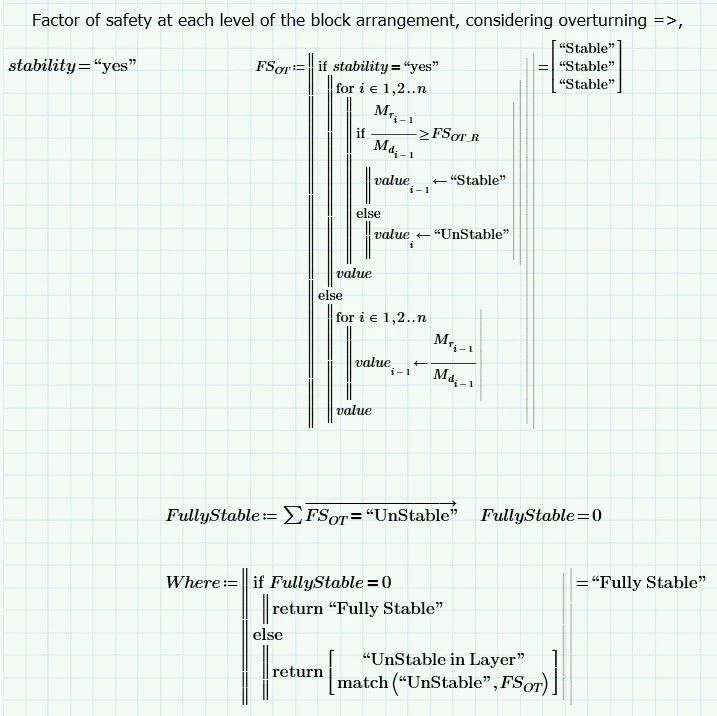

I have a Mathcad sheet which I am working on to find the factor of safety for block walls. The sheet will calculate and spit out a text "Stable", "Unstable" based on a comparison , which I have provided in the logic. What I request to have is a Mathcad prompt, that checks the array FS_OT to see how many "UNstable" are there. If so, it should send out a message saying "UnStable" and tell me at which level of the layer of blocks are unstable. Please help on this as I am not that pro level. My Mathcad version is Prime 10. This is not an error issue so no screenshots were provided.

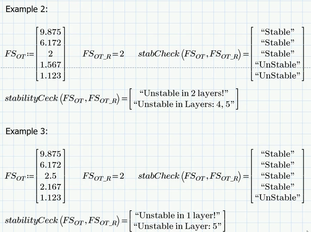

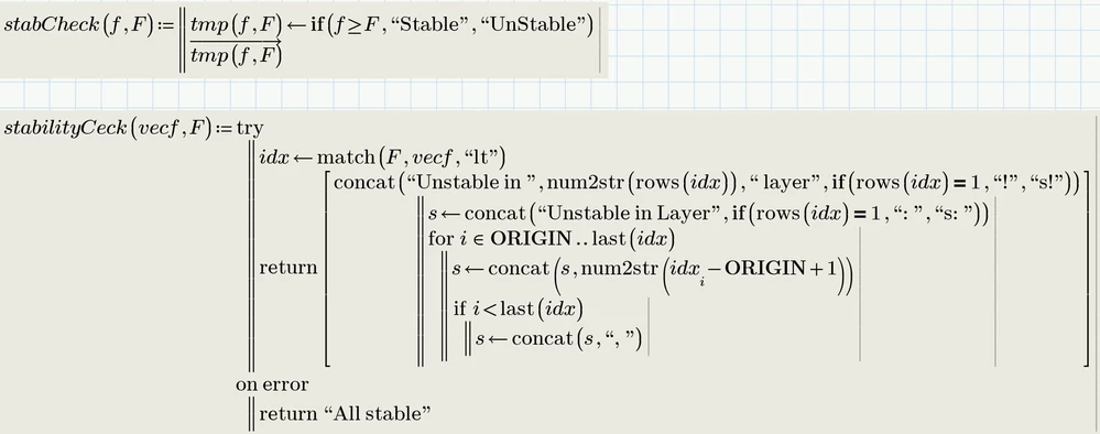

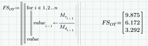

Here are my 2 cents worth.
I would only calculate the values:
And, although not absolutely necessary, I would define auxiliary functions
and use them to make the desired stability outputs based on the data:
Example using different data:
Prime 10 sheet attached
terryhendicott
Function you are looking for is match().
Match returns an error if there are no matches so no need a test before its use.
