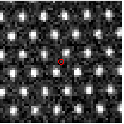

I have create a set of random locations and then at each location I place an object to simualte an image.
The delta just makes sure no objects are within 3 pixels of the image edge.
I know want to be able to change the locations now to represent the following regular pattern. I believe horizontallt there is a pitch of 8 pixels, and vertically a pitch of 9 pixels with a horiztonal shift of 4 pixels.

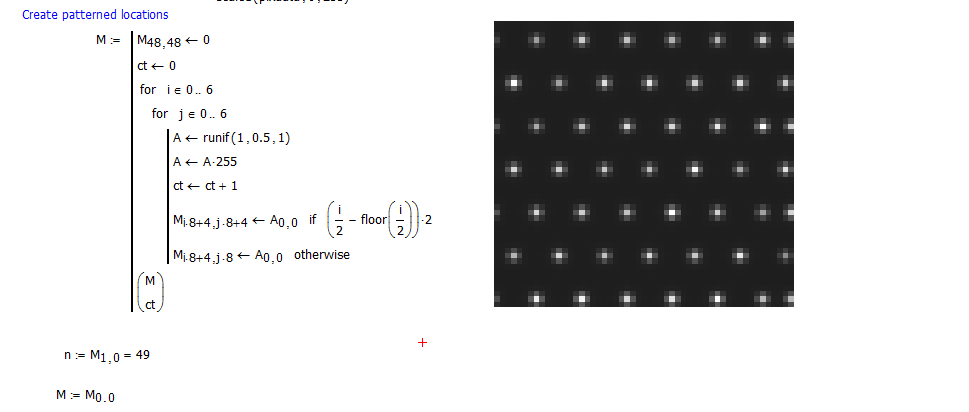

January 18, 2016
Something like this?

Thanks Richard - its a while since we last spoke on this forum!!
Please see the attached, you  helped me before a couple of years ago place a point spread function of random amplitude at each of these locations.  I have tried to combine your previous work with this patterned location array and nearly have it, there's 3 issues that have arisen though and I'm not sure how to do them.
In particular:
1: How to count the number of objects, I tried the following but its not right.
2: How to apply random amplitudes to the objects  using
    amp=runif(n,0.1,1)         - but how to then apply it to the objects in M?
3: How to get rid of the strange edge effect ont he right hand side
and lastly, how to allow for a random 0.5 pixel shift so that each psf is not necessarily centred exactly on a pixel.
Jason
Jbryant611-VisitorAuthor
January 20, 2016
I've managed to answer my own questions, not sure if its the most elegant way.  I included the randomw amplitude and object count in Richards original function.image01.png
Im still getting a strange edge effects on the RHS once its convolved with the psf.
