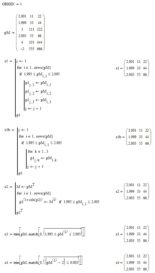

I am trying to replicate a programming block that my professor sent me to implement into a larger mathcad sheet/program. However, I'm getting a bit lost on the formatting of it. The screencap of the correct block is shown below.

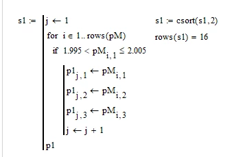

And then there's my attempt at it so far. I'm mostly confused about the value the if statement falls back on to if the following statements fail.
Any help would be appreciated! I'm used to just using MathCad for "cheat" sheet style calculations, so I'm lost on the programming logic of the language.

The program shown simply creates a new matrix consisting only of the rows of matrix pM (or at least the first three columns of it), where the value in the first column is approx. 2 (within a distance of 0.005).
So if the "if" statement fails, no rows is selected and nothing has to be done.
The first error I see is that you did not use matrix indices when writing pM[i,1.
Then you probably are confused because the statement for the if statement are not indented and placed in the next line? The reason is that Mathcad is doing so only if there are more than one statement in the if.  If there is only one statement, its placed to the left of the "if".
So put your first statement in the black placeholder to the left of the "if" and then add a new line (either from the palette or by pressing "]") and you will get the structure you are looking for.
Attached is a Mathcad 15 file along with a couple of alternative ways (without error checks) to achieve the same effect (assuming the ORIGIN should be changed to 1 and that pM is a matrix with just 3 columns)
