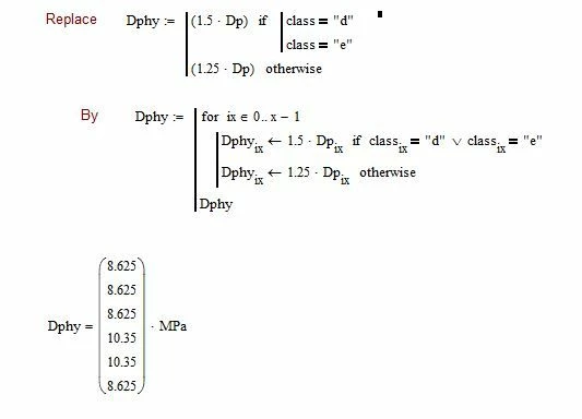

Help with if loop with array
There's no error in the worksheet, but the answer is incorrect. How do i define in Mathcad so that it would read each scalar in the array instead of a whole.
(Mathcad 15)
One way is as follows:
23-Emerald V
Yes, no error message from mathcad. ..
And the answers are all correct...given the equations and formula.
BUT: what did you expect to get. What is your purpose?
Please explain.

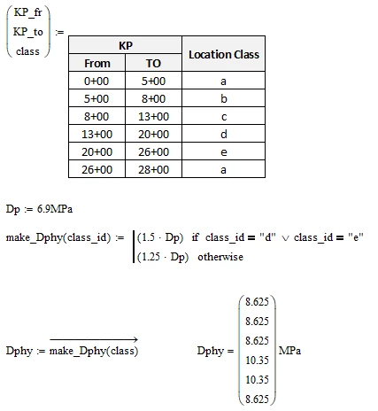

Turning the calculation into a function and calling that function vectorized might be an option.
Furthermore you have to use the logical "or" operator to connect your two conditions.
You don't have to name the formal function  argument "class_id" as I did, you may name it simply "class" as well.
Furthermore you may consider making "Dp" a second function argument.
