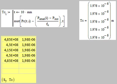

Kindly refer to attached worksheet, need advice on how to show Tc(i) as an array in excel component instead of a scalar. Would also greatly appreciate if anyone can explain how mathcad component read Tc(i) and causes a value to be shown only.

You have to be aware that a range (like i in your sheet) is NOT a vector or an array, but some kind of implicit loop.
So Tc(i) is no array either (try to assign Tc(i) to a variable - it will fail).
Simply create a vector Tc by writing Tc[i:=.... instead of defining a function Tc(i) and use Tc as input for the Excel table.

Instead of defining Tc as a function, define it as an array Tci,
then you can call Tc instead of Tc(i) in the excel component.
