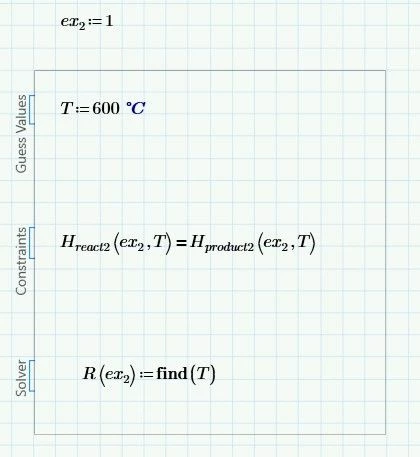

I use Prime 8 so will use images to show you what I did.  Perhaps some one in the community can change it to Prime 7.

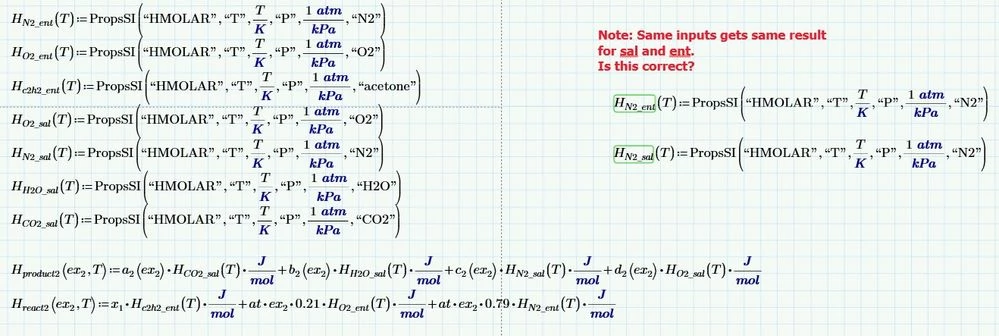

A) Move all the function definitions in the solve block to above the solve block and change the equal sign.
Can you check some of the formulas?
B) Define only one ex2 . Turned the solve block into a parametrized function in ex2.  One equation one unknown T.

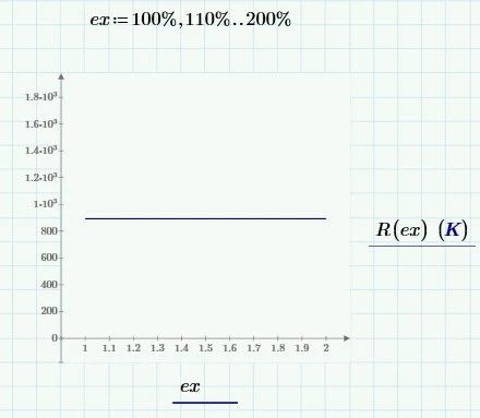

C) Defined a range variable ex and used it to calculate R at every ex and plotted it

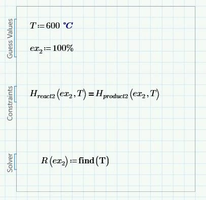

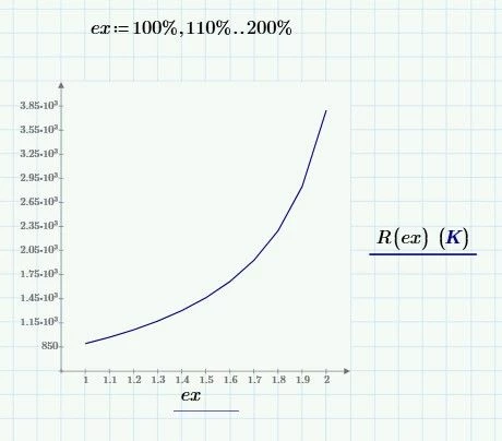

terryhendicott
Aug 22, 2022 6:37 AM UTC
Have made a small change that is needed.
Put definition of ex2 above the solve block.
This gives a more believable graph.
