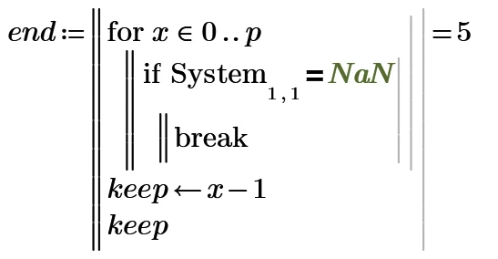

You should also realise that:
1.
contains the value 2.54, because index counting starts at 0 (controlled by the value of system variable ORIGIN).
2.
The test
will always return False, because to test for NaN's you'd have to use the IsNan() function.
3.
Your loop is a bit silly, becasue you are testing the same thing over and over again.
The reason the result of your program is 5 (after applying TTokoro san's correction) is because p=6, if you set p:=3, the result of your program will be 2, because the program defines keep := x -1, and x runs from 0 to p.
4.
The top left corner of the matrix System (at index 0,0), contains the string value "Size", which is not a number but it is also not a NaN.
(a NaN is a special number, defined within the IEEE number format)

8-Gravel
Mar 5, 2025 10:14 AM UTC
Thank you for the detail I made the changes but still for some reason it does not work. How do I go to correct this?
