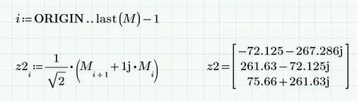

Werner_EAnswer
October 6, 2022

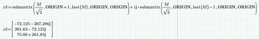

Remark:
You could also do without using a user-written utility function, but I sure would prefer using the function
or even without an extra range variable, using "submatrix"

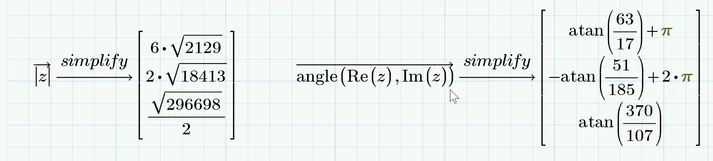

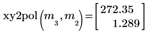

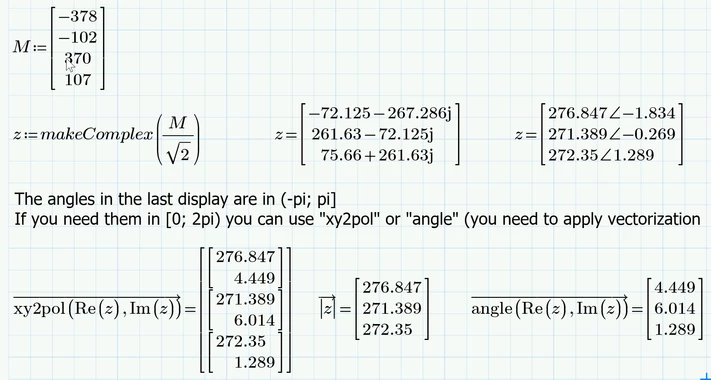

More precisely (without retyping numbers causing accuracy loss) you may get:
Then why not simply (without detour):
October 6, 2022
Why not use a utility function which can deal with vectors of arbitrary length?
And in case you are interested in the exact values, you can use symbolic evaluation

Remark:
