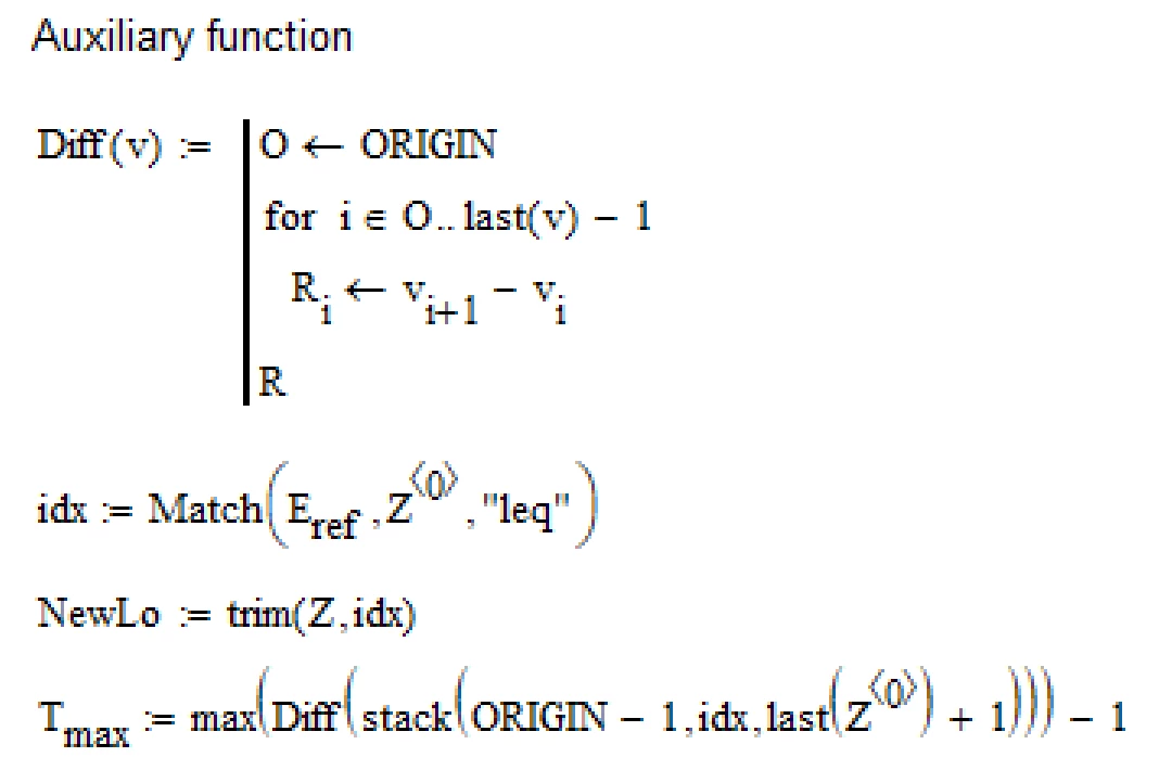

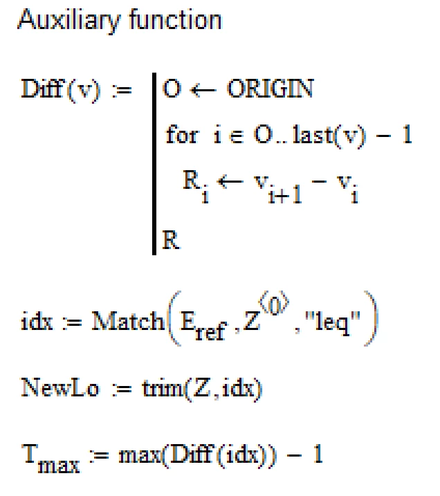

Just an additional thought. If you trust match, than there seems to be an easy way to get your T.max.
Match(E.ref,Z<0>,"leq") gives you a vector with indices of all values less or equal E.ref which corresponding rows then get deleted from the matrix. So the longest run in the remaining data is the greatest difference in the values of that index vector minus 1.
July 8, 2018
Small correction!
The above will miss the longest run if it occurs at the beginning or at the end of the data.
This will fix the problem:
