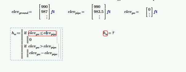

I am attempting to complete a comparison using values from a table and am getting a scalar value error. What do I need to do in order to get a column of values out of the attached.

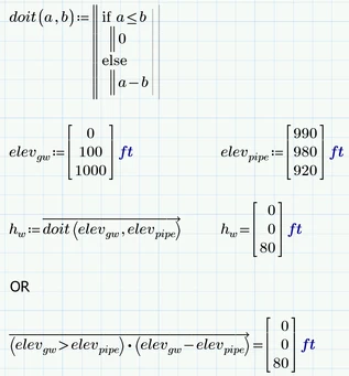

I would suggest that you turn the calculation into a function and use vectorization!
For more help you should post the worksheet, not just a picture.
