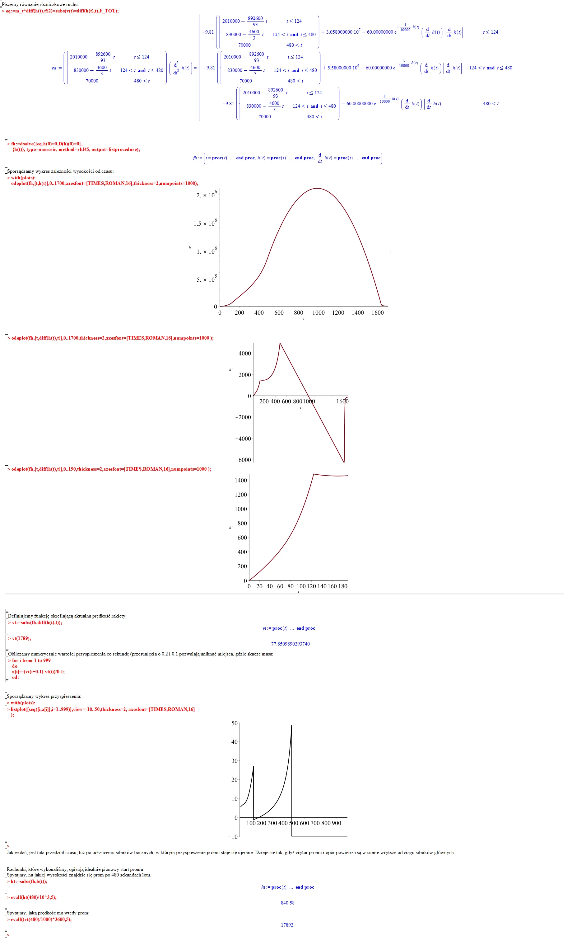

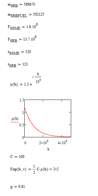

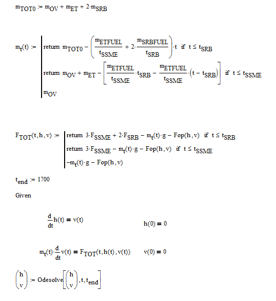

i need help with differential equation. so far i have something like this(mathcad file) a have to do something like this(screenshoot). i wolud appreciate any help.

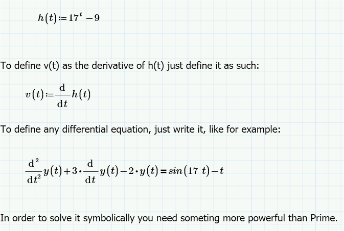

From your info I cannot determine which differential equation you want/need to solve. Your Prime sheet contains errors: it fails to define v(t).
You need to describe your problem accurately and concisely.

Yes I know becouse almost at the and i need to define v(t) as a diff h(t) and i dont know how to do it. and also my problem is that i can't (dont know how) write differential equation in mathcad. Everything that is in screenshoot or maple sheet I need to do in mathcad . If you know how to solve my problem it would be very helpfull.

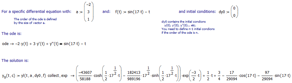

Example:
Like Mathcad 11:

and send please the Maple-sheet

ok I'll check this. im sending the maple sheet as You asked. If You know how to do it I would be very thankfull with any help.

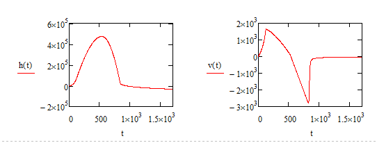

January 21, 2016
Attached is a Mathcad15 version (without comments).
These graphs look a little different from those in your .png file, but the transition times there are different from those given in the Maple file.
Alan
