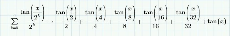

I have tried to solve this summation with symbolic calculation but it does not give me an answer:
If I give a value to n, I get an answer:
Which keyword or modifier should I use to get a response without giving a numeric value to n??
Would appreciate any help to solve this problem.

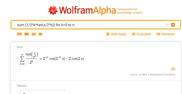

Yes, the simplification is correct but Mathcad's abilities are unfortunately very limited when it comes to symbolic calculations. Especially when compared to more advanced systems like Mathematica or Maple or even whem compared to Uncle Wolfram (limited mathematica engine):
I am surprised that even Luc did not succeed as he is using mathcad 11 which includes an older version of Maple to do the symbolic calculations.

September 14, 2017
What would you want the solver to show for the generic n?  This?
tan(x) + tan(x/2)/2 + tan(x/4)/4 + tan(x/8)/8 + ... + tan(x/2^n)/2^n
This is beter shown with the sigma summation -- as in the original equation.

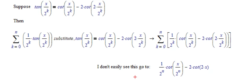

You're right, but what I want is to come up with a simplified summation result like this:

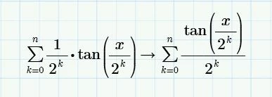

For this I manually use this property:
How can I implement it to get the desired result??

I'm afraid you will not succeed.
Where did the summation go to?
