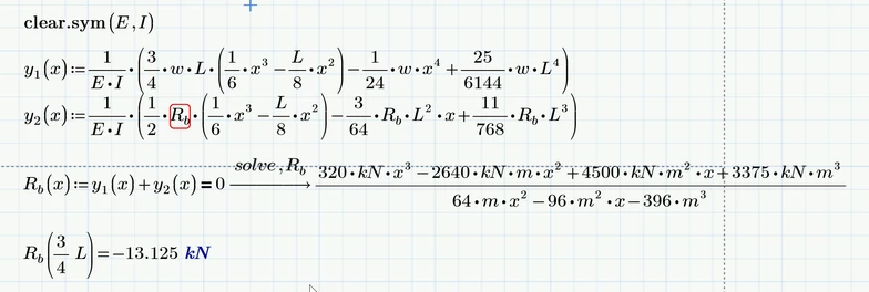

January 14, 2022

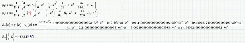

Here is an approach with an ugly looking solution
The ugly look stems from the fact, that E and I are defined as floating point numbers and so the symbolic switches to float mode.
You may clear E and I only for symbolic calculation and the result looks nices. After all E  and I cancel and are not present in the result anyway:

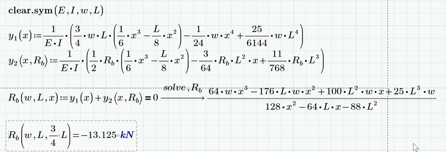

You may also clear the other variables and make the result dependent on w and L additionally to x:
I also made y2 dependent on R.b to avoid the red error message which comes from the numeric processor but does not affect the symbolic evaluation.
