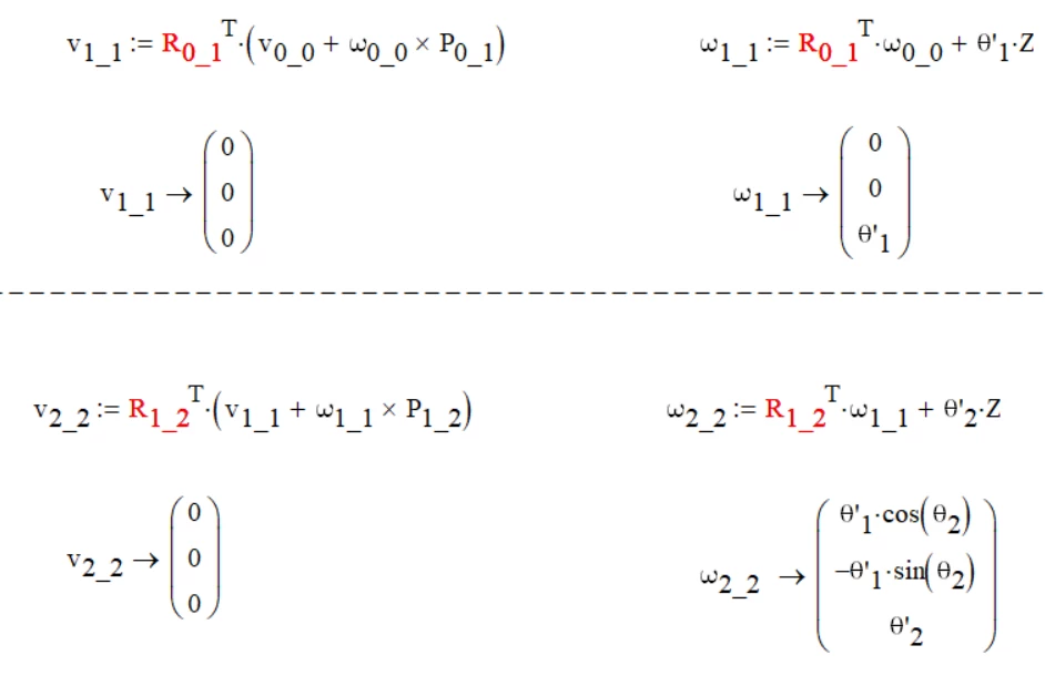

Hi everyone,
I am trying to work in an exported file from Mathcad 15 M050 to Prime 6.0

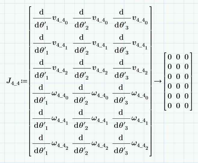

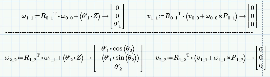

I am working with symbolic expressions where I used prime variables to define velocities of an angle. In Mathcad 15, I use CTRL+F7 to add the apostrophe to the variable, but in Prime 6.0 it doesn´t act the same way. I tried to use the one in the "Operators" menu, but it doesn´t operate the symbolic expression the same way.
If anyone has a possible solution, I will appreciate it. Thanks in advance.
I´ll add some images of part of my file, in Mathcad 15 and Prime 6.0

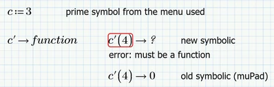

Attach your worksheets if possible. A picture may paint a thousand words... A worksheet in general helps much better!
In Mathcad the prime symbol attached to a variable or function has no meaning, unless you're defining a (set of) differential equations in a solve block (see the help description there).
In Prime the prime symbol actually is an operator defining d/dt (or d/dx) whatever the parameter of the function is.That means that y' will always yield 0, unless y is a function of a parameter to a degree other than 0.
If, in Prime, you want to attach to a variable or function a prime symbol that's not an operator, type the variable name including the prime symbol as a string, so within double quotes, then delete one of the double quotes (the other disappears also, and you have you primed symbol).
Example: To get y' type "y' followed by the Del-key (that deletes the closing double quote).
The weird numeric result of the first c'= indicates a special situation. The second c'= is clear.
I can't do the symbolics, I'm limited to Express. But the symbolic processor handles undefined variables, so it will allow c' -> (the symbolic evaluation of c' ), interpret it as the derivative of c which, with c=3, yields 0.

The apostrophe you get in MC15 when pressing Ctrl-F7 has a special meaning - derivative (prime symbol). But in MC15 this only applies to solve blocks with odesolve, otherwise the prime symbol is just seen as an ordinary character in the name of a variable and thats how it is used in your MC15 sheet.
In Prime this apostrophe has the meaning "derivative" throughout the whole sheet and as the derivative of a constant is zero, you see the zeros in the results.
The converter keeps the meaning "prime symbol" and that can be the cause of some problems.
But the problem shown in your pics where derivatives are used is a different one, I think. The symbolic acts differently in Prime compared to real Mathcad and this applies to the new symbolic introduced in Prime 6 as well as to the old one (which you still can switch back to in Prime 6).
There seems to be no easy solution other than changing the variables to true functions with argument(s).
Mathcad 15:
Prime:

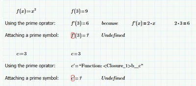

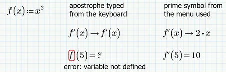

Remark: To create a variable or function name with an apostrophe, you don't have to use any tricks in Prime, you can simply type it from the keyboard. Its not interpreted as prime symbol even though it looks the same.
BTW, Luc's example (the one with c:=3) doesn't work in Prime as he (and also me) expected:

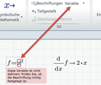

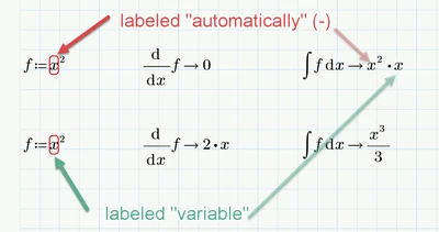

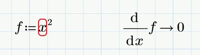

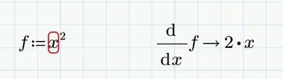

EDIT: Further investigations showed, that its (again) a new problem with Primes infamous auto-labeling "feature".
In the pic above both "x" are labeled "(-)" meaning "automatically" or "auto-detect". If the "x" in the expression "x^2" is manually labeled "variable", even Prime 6 is able to give us the symbolic result "2*x":
When I tried an integral instead of the derivative I noticed that Prime dealt with two different type of "x":
This means that your sheet may work as expected if you change every apostrophe to a manually typed one and label manually every variable you intend to take a derivative with respect to it as "variable".
That way it could be possible to avoid defining so many functions explicitly.

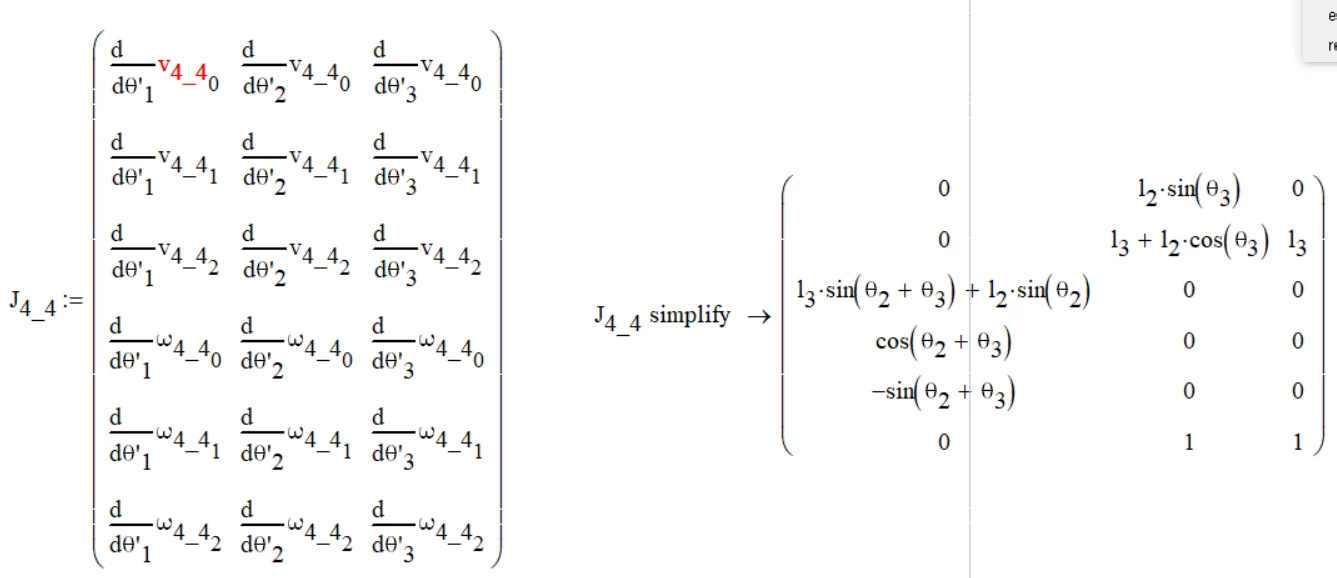

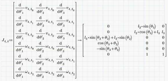

Heureka!!
Now it works in Prime 6, too. It mainly was the problem with Primes auto-labeling.
In my simple example f:=x^2 it was only necessary to change the label of x in x^2 to "variable". But in your Jacobi matrix it was also necessary to change the label of the variables in the derivatives d/d... manually to "variable" and now it works.
Changes done:
1) Change all apostrophes (prime symbols) to manually typed apostrophes to avoid interpretation as derivative
2) Manually labeled all theta1', theta2', theta3' on the left hand side of an assignment and also in the Jacobi matrix in the derivative to "variable".
Step 2 is something you obviously would have to do with every variable you intend to derive after.
Step 1 is necessary because the Mathcad->Prime converter does not realize, that in MC15 the apostrophe is interpreted as prime symbol (derivative) only in solve blocks with odesolve and otherwise should be treated as a normal character of the variable name
Step 2 is necessary because of Primes very faulty auto-labeling feature, which quite often is more of a PITA than helpful (sometimes it can be very helpful, though).
Prime 6 worksheet attached.
