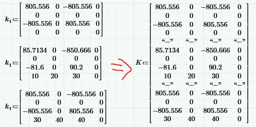

HEPL!! How to join many matrices in only One?
I wanna join or pass many matrices in only one....
Please look the attached image
its posible?

Your matrices should not be all named the same (k.1)
As you have a variable number of matrices (all with the same number of columns) you could store them in k[1, k[2, etc. and I mean vector/matrix indices here, not literal ones.
Now you could do it that way

Use the "stack" function.

it's not possible because the number of matrices to join is variable or dynamic......

You can pack matrices into a vector generating a MDA. Further you can acces each one with vector subscript.

i have modified little bit the code but thank you so much.
Its solved
