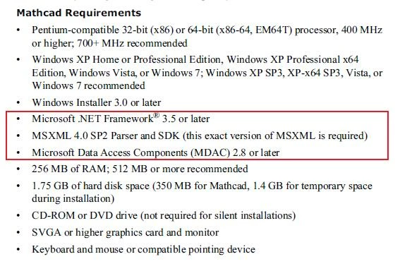

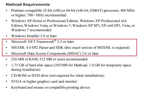

1. For Mathcad 15 on your PC should be preinstalled the following Microsoft components:

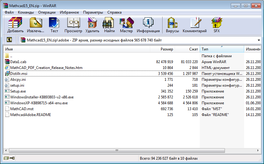

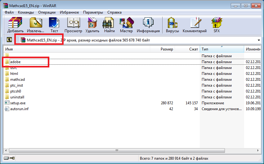

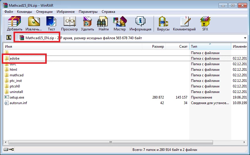

2. Try to reinstall "Mathcad PDSi viewable support" component (by Adobe Systems) from your Mathcad package. But first: uninstall it --> reboot --> try to print PDF file from worksheet by using different PDF printers.
