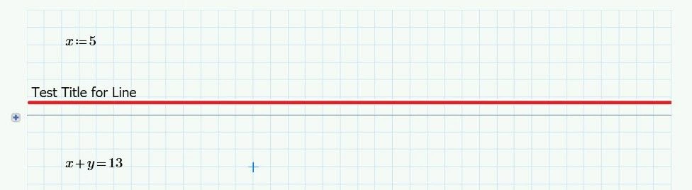

No you cannot change the properties of the line once the area is closed but you can format it like this with a heading.
The line bmp is 890 x 7 pixels for my screen.

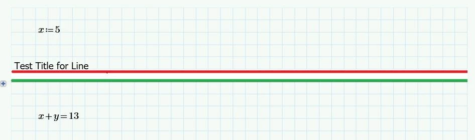

Aug 4, 2023 2:34 AM UTC
It also works without an external image file. The spaces to the left and right of the text are set to 3 point size and highlighted in red. Additionally the whole text field can be highlighted in another color if desired.

Aug 4, 2023 3:21 AM UTC
If you set the image to 890x24 a bottom line in the image will cover the area line and you can format it any way that paint allows.

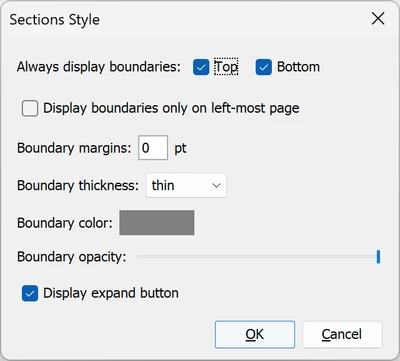

PTC could learn something from Maple Flow.
