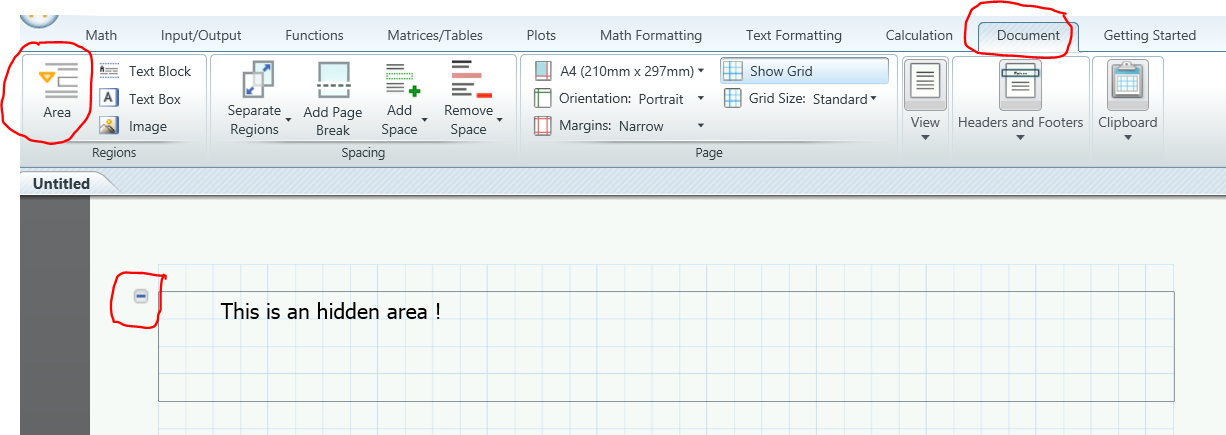

I am trying to hide a calculation region how is that done?

Hi there,
What version of MathCad you are using?
If the version is prime, you can add an hiding section in the following menu:
Document -> Area or just type CTL + SHIFT + A
Then make your calculations and press (minus) at left corner of area. And the area will be hidden.
Plese check picture attached:
LL

Mar 15, 2015 6:34 PM UTC
Thank you so much, it works great.

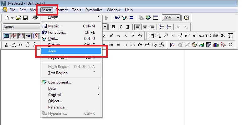

Mar 10, 2015 8:11 AM UTC
In Mathcad 15 you need to select in main menu "Insert" -> "Area". But unlike Prime version you can set a password on a hidden area (right click on area and select "Lock").
