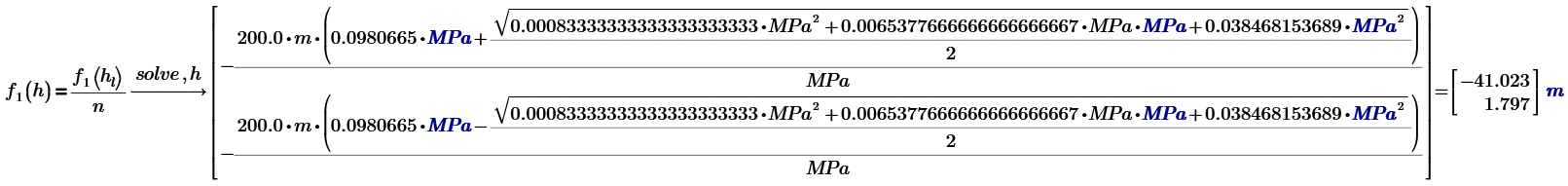

Do anyone know if its possible to hide parts of my calculations? I solved an equation and got some ugly looking, precise answers. I only want to show the approximate decimal answers.

Add a numeric assignment at the start of the expression, and then use the max function:

If it's possible i want to hide the answer part with the sqrt.

Does 1.797 got a name now? Like h2 or something? Or is it possible for me to name the biggest value h2 automatically?

According the need to hide that big and ugly expression you got using the symbolics: Is it necessary for your audience to to see the first part, that is the equations and the "solve h" ?
If not, you could assign the calculation to a variable h, similar to what Richard had done with X, and put the whole calculation line in a so called "area" (Menu: Document - Regions:Area). You then can collapse that area and all you see is a plus-symbol at the left side and a horizontal line. After that area type "h=" and all you see is the calculation result.
And if you just want to exclude the calculation when you print the worksheet, you can put the calculation to the right hand page - what you place there is not printed.
