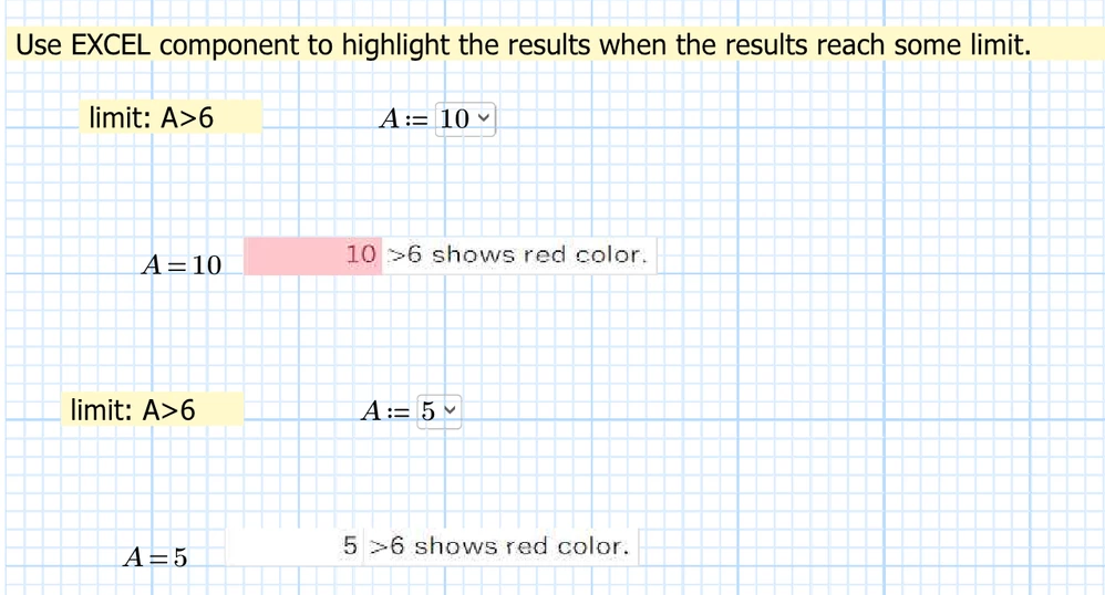

highlight color according to the calculated results
I'm using MathCAD Prime 8.0.
I want to highlight the results when the results reach some limit.
For example, the calculated result is in white normally, and when it reaches the limit it's in red to give an alarm.

You're not the first to ask.
Vote here: https://community.ptc.com/t5/Mathcad-Ideas/Conditional-formatting-of-outputs/idi-p/736333
September 8, 2022
oh, no...
I just think it's a necessary feature.😅
Thanks anyway.
ttokoro
September 9, 2022
t.t.
