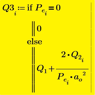

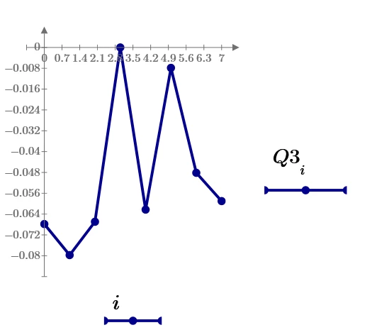

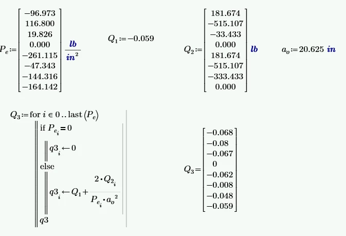

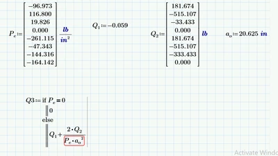

Your if test is looking for all of Pe to be zero.  Here's one way of overcoming this:
Alan
