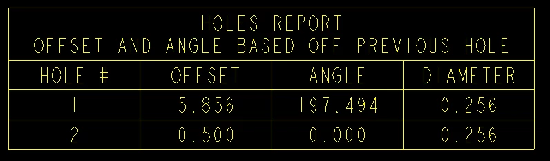

Holes Report in Piping
  • August 7, 2017
  • 0 replies
  • 789 views
Holes_Table.PNGWe are wanting to use the Hole Report Table on our drawings for holes in tubes we create in piping. However one issue we are having is that if there are more than one hole the hole location or "offset" as is shown in the table is not based off the start of the tube but off the prevous hole. This would require the person drilling the hole to add, and we cant ask them to do math. Is it possible to have the offset and angle all come off the one end point? Also we have problems if the tube is started at different end and then "connected" together the dims we get in the table are strange. That issue is hard to describe.
