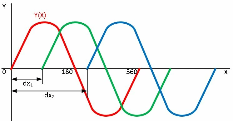

I try to draw a function several times on the same graph, but with a displacement "dx" on the axis of the abscissa as shown in the attached document.
I hope you can help me.

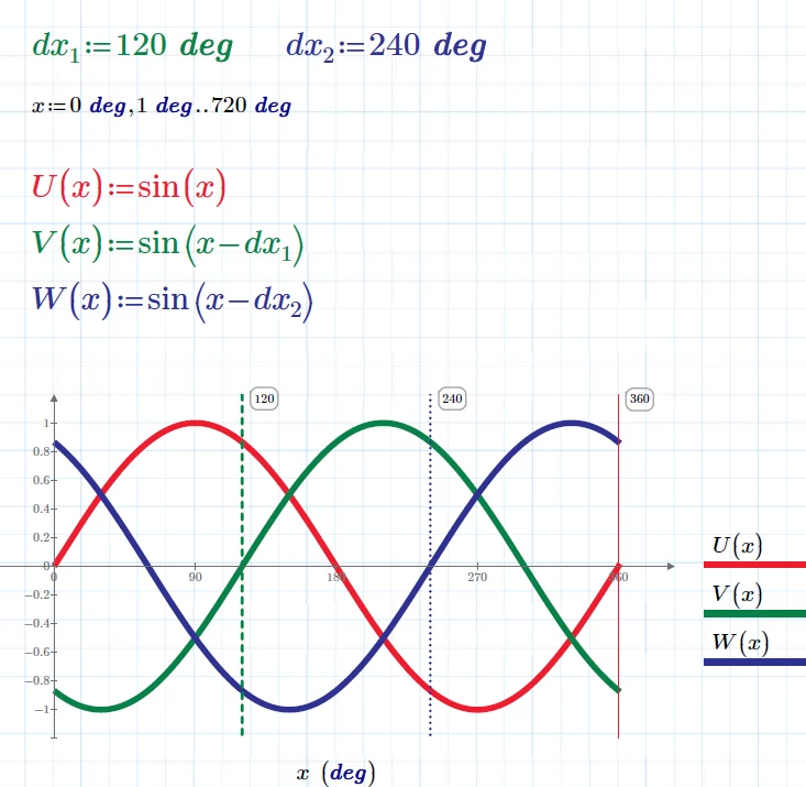

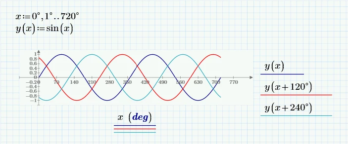

Solution is simple
Define the range for the plot and the function
x:=0°,1°..360°
y(x):=sin(x)
Create a Plot - plot the three functions - adding the displacement to the argument.
y(x)
y(x+120°)
y(x+240°)
Solution is simple
x:=0°,1°..360°
y(x):=sin(x)
y(x)
y(x+120°)
y(x+240°)
