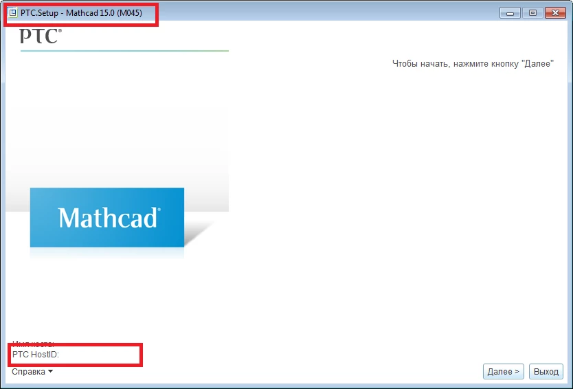

November 3, 2017
If you run the installer of Mathcad 15 (link is: http://download.ptc.com/products/mathcad/trial/mc15/Mathcad15_EN.zip ) then at the first step of the installation you will see your network card address (in the lower left corner).
