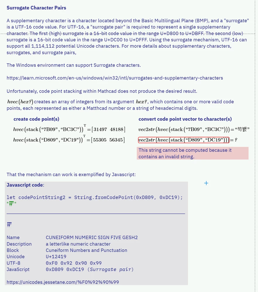

The restriction to valid integers being < 256 isn't strictly true.  Mathcad string vectors can contain many code points from the Basic Multilingual Plane (BMP) (ie, values < 65536 U+FFFF),  Mathcad strings do not, however, support code points in the Supplementary Planes (eg, the Supplementary Multilingual Plane U+10000 - U+1FFFF).
There is, however, a mechanism called Surrogate Pairs that provides an alternative to indexing a character in a Supplementary Plane.
I'm not sure whether Mathcad doesn't support surrogate pairs, or whether I'm not using them correctly.
