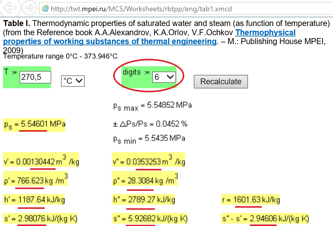

I ask 20 years MathSoft/PTC show not digits AFTER decimal point but COMMON numbers of digits in answer.
I use in Mathcad Calculation Server one function for this
See one example please
http://twt.mpei.ru/MCS/Worksheets/rbtpp/eng/tab1.xmcddigits.png

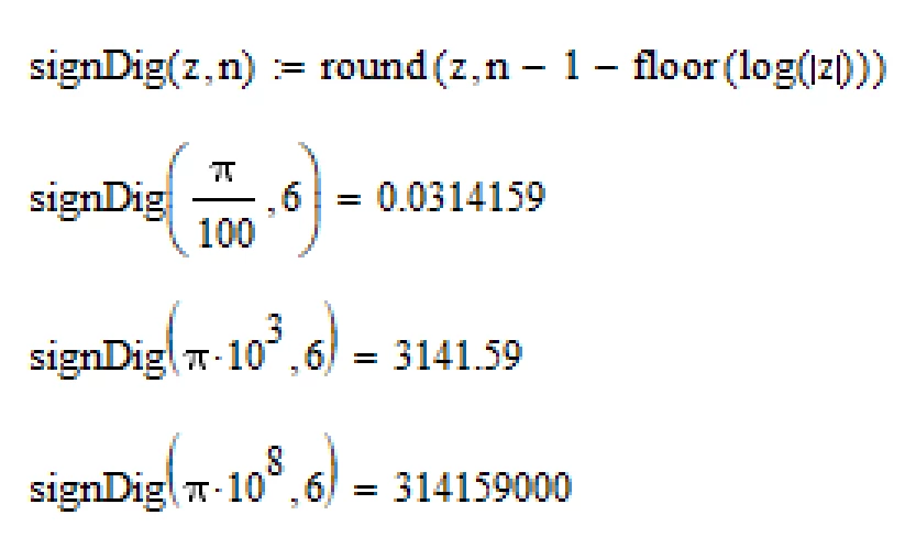

Here's a simply way to round a value to any number of significant digits rather than to a number of decimals. B1.png
But the OP had asked for something quite different, namely the possibility of cutting off the decimal places.
And the answer was already given by Terry.

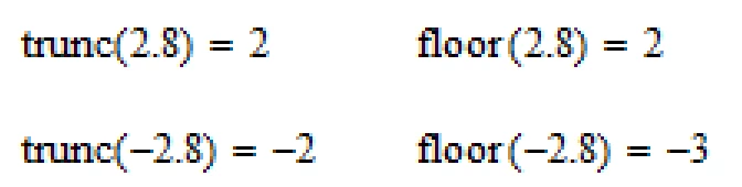

Mathcad offers a function to do exactly what was asked for - "trunc".
If negative numbers should be treated differently, "floor" might be an option.
