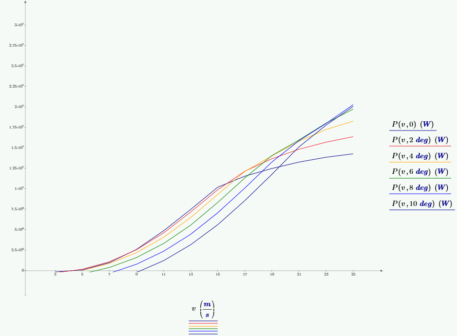

How can I change this graph?
I want to find each point when it reach 5*10^6.
And then I want to connect each point.
when all work is finished, it will be made one line.
could you give me advice?

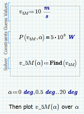

Maybe something like this:

I clear my mission. it is due to just" CTOL".
I changed value "CTOL" and then I solve my problem
Thank you Werner and Richard.
