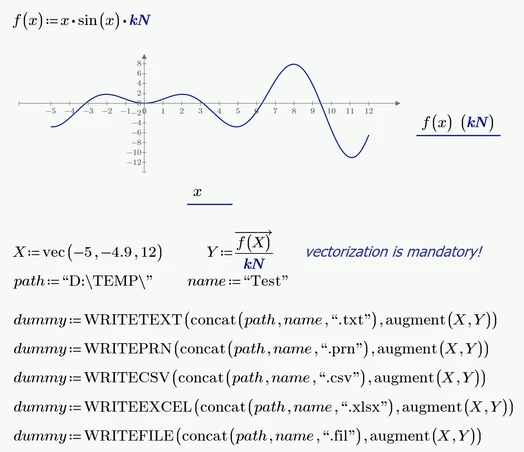

Hi everyone,
I have a plot in Mathcad and would like to export the underlying data to a .txt file.
What is the recommended way to extract the data from a graph and save it as a text file?
Thanks in advance for your help!
Jan 16, 2026 11:45 AM UTC
Create vectors for the x- and y-values in increments of your choice and export them using WRITETEXT, WRITEPRN, WRITECSV, WRITEEXCEL, ... whatever seems appropriate.
In Prime you don't need to divide by the desired unit - there is a placeholder in the plot where you can type in the unit
