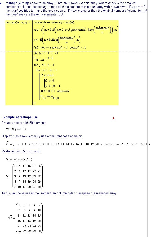

I haven't got Prime and I'm not sure what you're trying to achieve, but if the intent is to show the last element of the vector, then can you simply drag the slider bar down the display until you reach the last element?
If you simply want a more compact display, and don't mind that it's shown as a matrix, then reshaping the vector into a matrix might help.
Stuart
