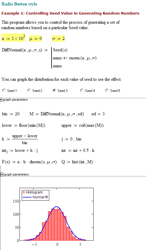

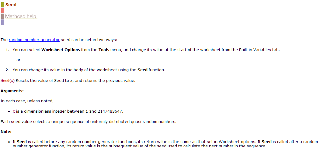

Probably the "Seed()" command is what you are looking for.
Here are the screenshots of Mathcad 15 's help
and from the appropriate Quicksheet:
