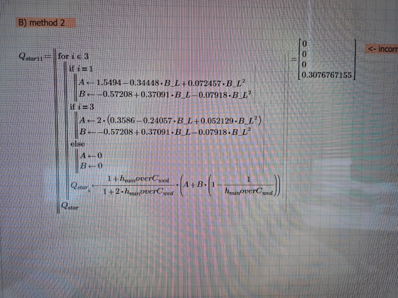

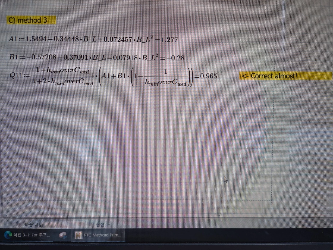

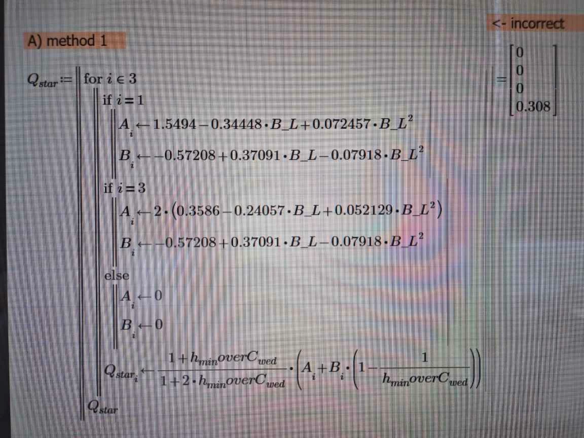

How can I get results in a column vector Q with respect to each coefficient Ai and Bi?
I'm a mathcad prime 10 user.
I need to have Q1 with respect to A1, B1 and Q2 with respect to A3, B3?
It doesn't really work out in method 1 and 2.
The correct result should be the value in method 3 when considering Q1 only.
Jun 27, 2024 11:37 AM UTC
this notation means that variable i takes only the value 3
this notation means that variable i gradually acquires the values ​​1, 2, 3
Jun 29, 2024 9:02 AM UTC
Thanks! It works well.
