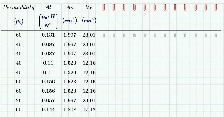

It is a great tool, but how can I replace Excel in a inductor design like the image attached?
Where I need/can see the different designs all together to evaluate them.

Use an input table to enter inputs,
Use a matrix to show inputs and calculated values.
Like this.  You actually  get the units in Mathcad.  The columns of the input table are variable names for a column vector of values.
To display it identical to the spreadsheet.
Create a matrix by augmenting all the column vectors, Then transpose the matrix
