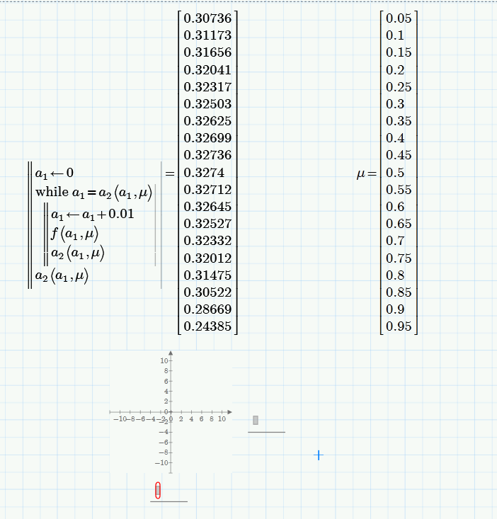

I have another question. I want to make graph about my data.
x-axis will be used by right data in the picture. y-axis will ble used by left data.
thank you for reading my question. (I attached my file)

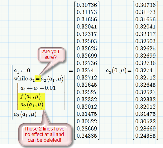

I don't think the routine does what you intended as it will always return the same as a2(0,my).
I have attached a file with what I think is you are really looking for - at least from what I had understood from your first question a few days ago.

Root is a built-in Mathcad command which uses some sophisticated numerical algorithm to get the root of an equation and needs a guess value to start with.
The same is true for the solve block I sent you in your other thread and which does exactly the same.
You tried to use a very simple algorithm to achieve the same. You got it right in your last thread but wrong (the 😃 in this one. Also, as I already wrote in the other thread, your approach of increasing the value of a1 by 0.01 until a1 and a2(a1) meet is a very crude one and will not give you much precicsion. So its better to rely on Mathcad's built-in, tested algorithms to get the result you want. They sure a more reliable and provide much better accuracy.
If its part of your homework to implelement a numerical algorithm yourself, you sure don't expect us to do your homework for you. And you have already succeded anyway, just use the routine you sent in your last thread. Delete the two unnecessary lines I pointed you to in my last reply and you are ready to go - with limited accuracy, of course, but this should not matter if the goal of the homework is to get you better acquainted to Mathcad's programming feature.
You posted a reply to Fred's posting which you deleted soon after (don't do that). This reply showed that you were confused over a result you got using two ranges. So I guessed you are not really sure about the difference between range variables and vectors. All the data structures in your sheet are NOT vectors.
