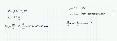

So my starting parameters are P1= 7.5 kW and n1= 750 rpm.
On the left side Mathcad is converting my units to SI which messes with my final results.
For this formula I have to use P1 in kW and n in rpm, which mathcad is changing into W and revolution per second. Right side is how to calculation is supposed to be going by the formula.
Is there a way I can fix this? I saw that in Mathcad 15 you could define a custom unit system. Is there anything like that for Mathcad Prime?
Thank you!

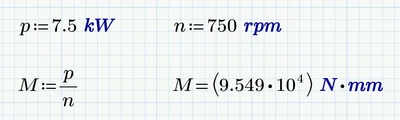

The formula you use has built-in correction factors (60/(2 pi) and 10^6) which are not necessary if you use units in Prime:
October 19, 2021
There is no custom unit feature in Prime. You're not the first to ask for/about it, and probably will not be the last.
So you've changed the unit of the Moment Mt1 from J to N*mm.
You should do the same with the P and the rotations: type a k before the W, and replace 1/s with rpm.

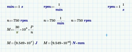

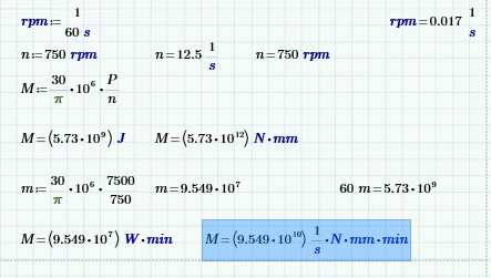

Mathcad hasn't really messed with your units.  You need to tell it (effectively) that your base unit of time is the minute,
or, more specifically, ...
