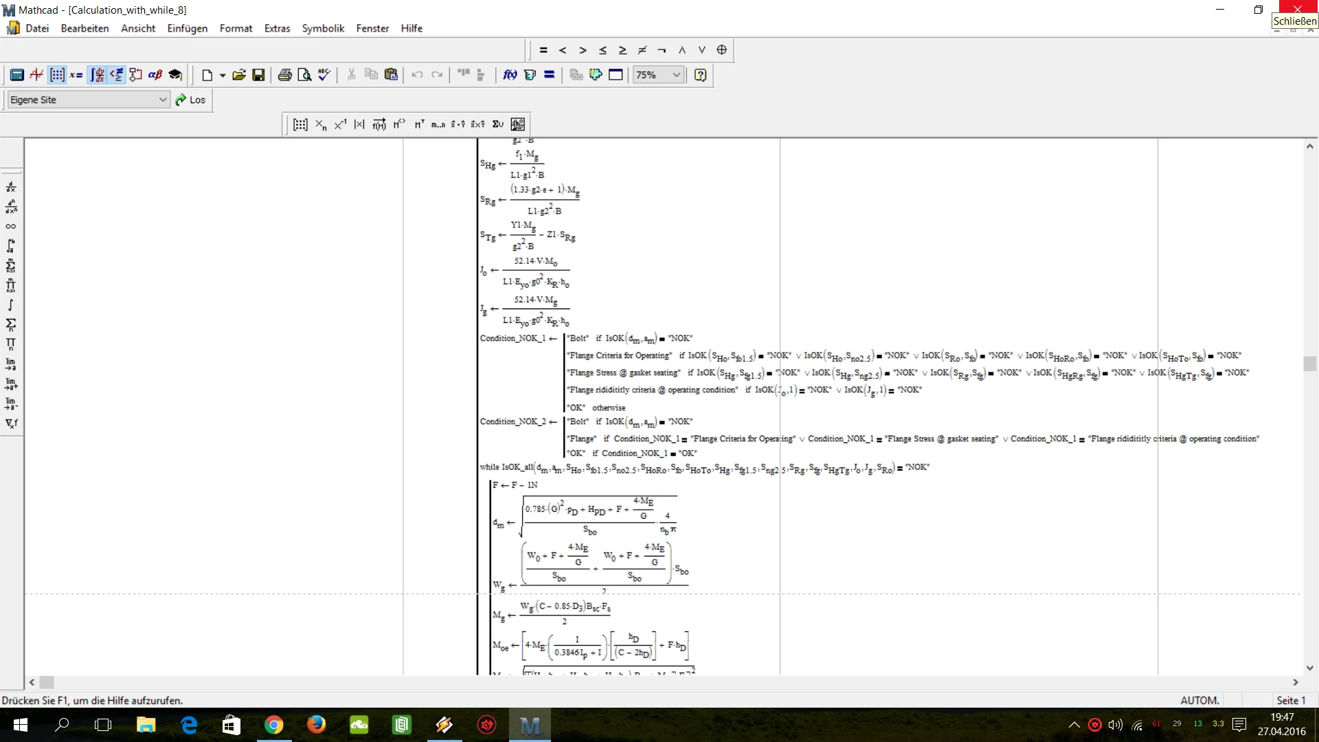

Hey guys,
due to my complicated and long Calculation i need to perform certain rowbreaks, so that i can print it on "A4" otherwise i would need "A2" format.
Now i have the problem that i dont know how i can perform a "Rowbrake"
As seen in attached picture...
Is that possible?
Thx guys

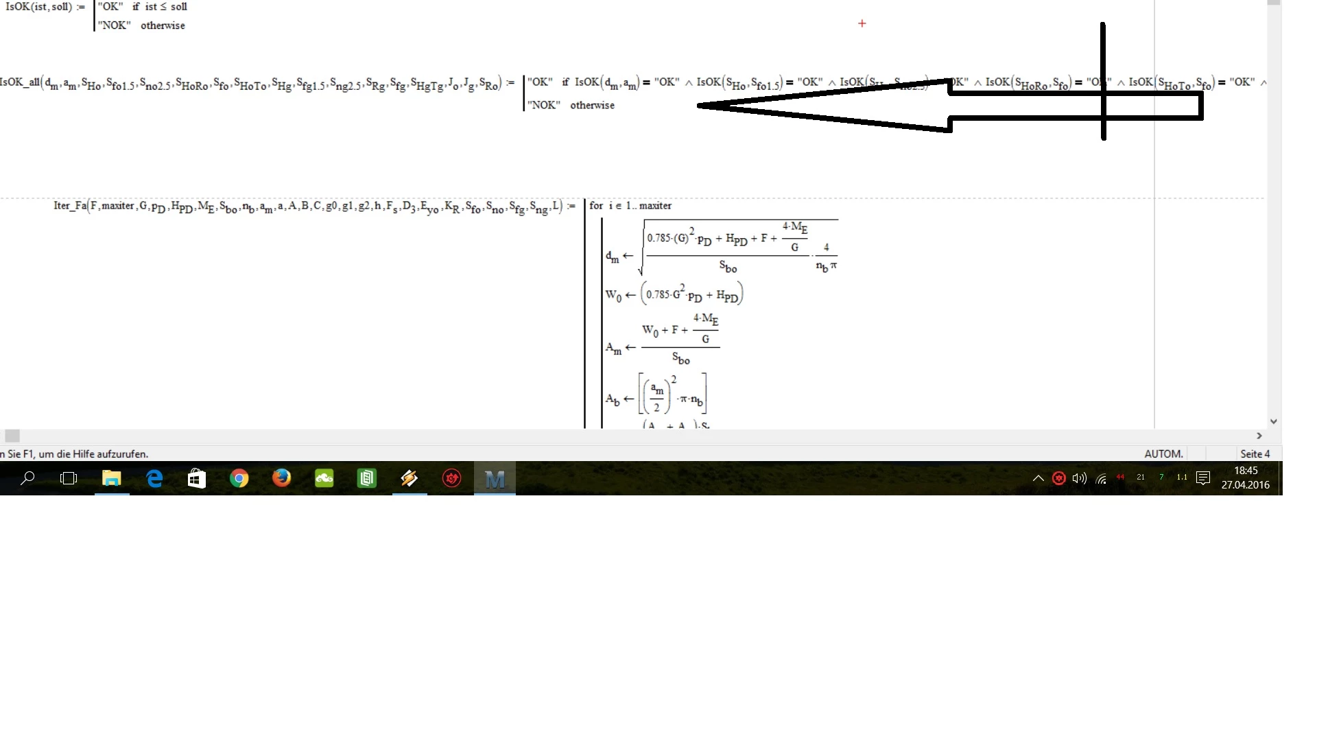

Seems like you're using Mathcad 15, which is good because in Prime it's not possible to do:
Which you obtain by pressing [CTRL-ENTER] instead of +.
Note that you can only break an expression at a summation point.

hmm ok and is it possible to break the hole loop so that it looks like that:
Iter FA.....:   ---- Rowbreak

Unfortunately, with the exception of the addition operator, you can't automatically break lines in Mathcad 15 (and below).
There are several methods of getting round the problem, which usually take up more vertical space (I assume that's less of a problem?).
The first thing you can try is reducing the size of your standard font - that may squeeze a few expressions into the page,
The second thing (which I assume you've either done or don't want) is to use Landscape mode.
Then you enter the realm of modifying your expressions to use less horizontal room.   For example, ..
  • Put your function arguments into a vector and either re-assign to the variables within the function or modify your function to pick the appropriate elements from the vector.
  • Break up long expressions manually and piece them back together again on separate lines.
See this image for some examples:

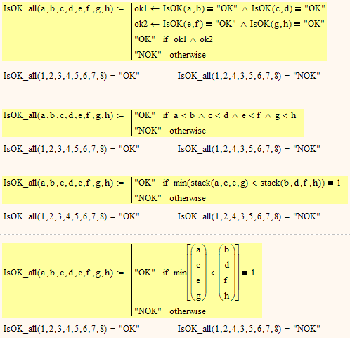

23-Emerald V
April 27, 2016
You're wasting a lot of space with your IsOK function.
Using it every time and checking if the output is equal to the string "OK" or "NOK" wastes more.
Why not have the function produce a logic TRUE or FALSE automatically by defining it as:
Then you can just test:
But even that takes more (horizontal) space than the simple and clear:

And also you could turn your evaluation method around, in returning when a condition is NOT met. So instead of:
You do:

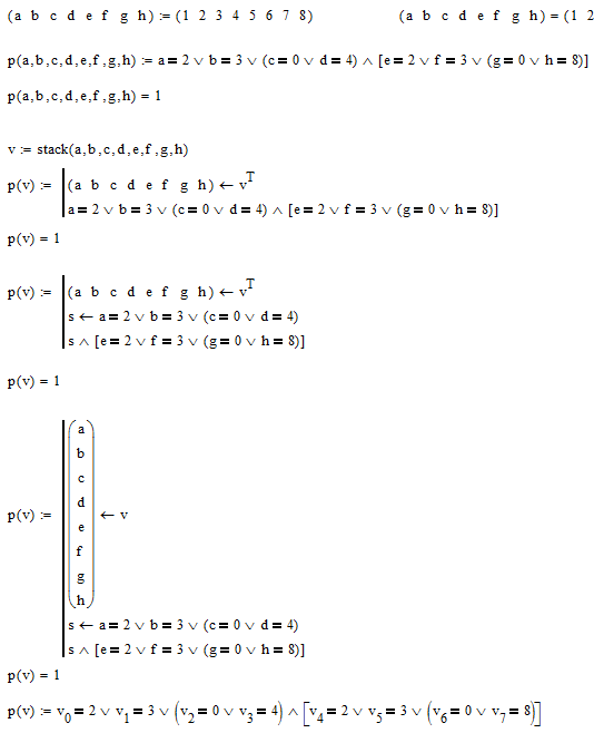

Here are a few more
But I noticed that your IsOK_all has an odd number of arguments?
