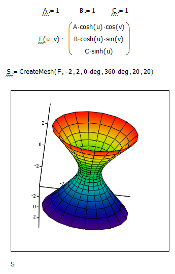

Jjcallao1-VisitorDec 2, 2016 8:25 AM UTCQuestionHow can I represent this function2 replies1347 viewsTranslate All3D-XplorMath Surface GalleryOther
