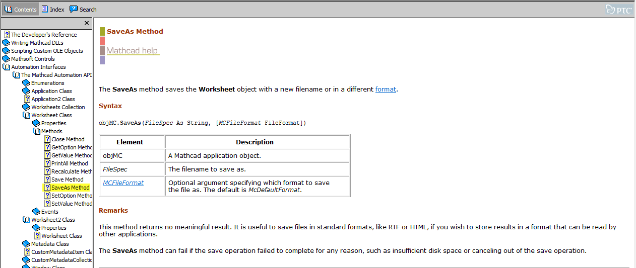

In Mathcad 15 help, Look at the Developlers reference and choose Automation API
You will see list of methods available in the Automation API.
Look at the SaveAs method. It save files in standard formats, like RTF or HTML, if you wish to store results in a format that can be read by other applications.
